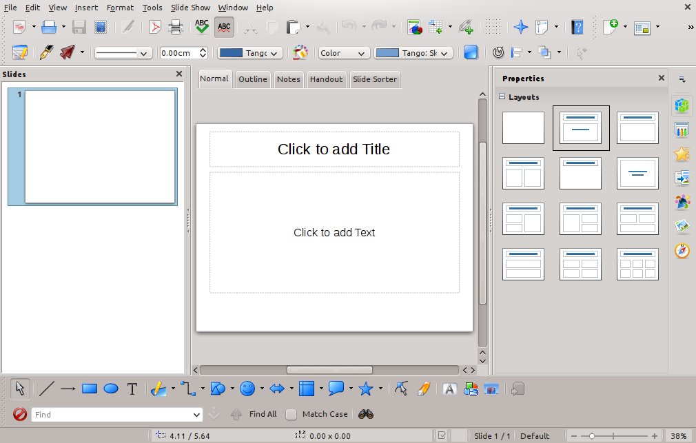

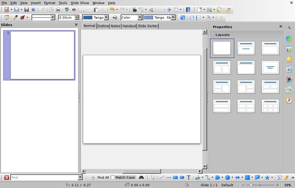

                        I have tried libreoffice-gtk and libreoffice-gtk3 but I have found that I am happier without any of these including libreoffice-kde. I find that with gtk I get larger icons and also on movies I briefly see a question mark before the start of the movie. Without gtk, I get a short white flash. The attached screen shots show the difference that I get on my system. I prefer the more compact layout.
