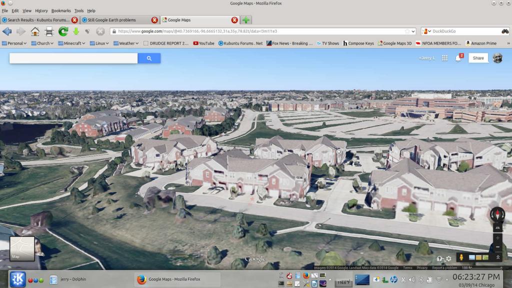

    Google earth has become a major PITA. If you use the new google maps, you can use 3D mode. I had to force webgl with firefox and intel hd4000 with this. https://www.google.com/maps/preview/?force=webgl

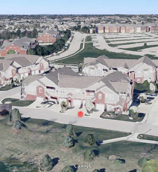

      Thanks for the link! When I use the regular Google Maps link it doesn't give me 3D. Your link does! The red star marks my driveway.
        Is it me or is it your missing red star?
          It's there, very faint, almost pink, right above the curb about 100 feet from the left curve.

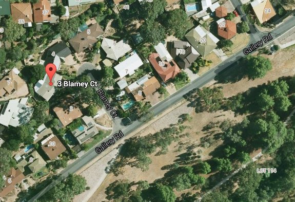

            Sorry GG but I am still having trouble seeing the faint marker. Now this is what I call a marker. For my area, the 3D view is not very useful, but the street view is. This is available at the bottom of the screen with the Explore option.
              I put a bigger dot on it.
