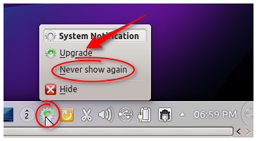

          right-click on the icon in the tray, or use the software-properties-kde GUI (also found in Muon as "Configure Software Sources") as I mentioned above.
            Change the setting in Muon:
              That worked.
