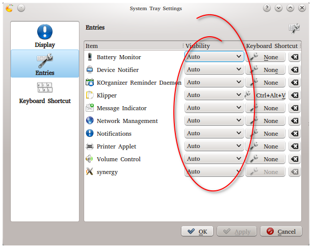

        Right-click on an empty area of the System Tray and click on System Tray Settings and then click on Entries. By default, each entry has a default Visibiity setting of Auto. You can change any/all of them to Hidden.

          1. Application icons in the notification area:
          This is an application setting ("show icon in the tray" or something similar) when the app is running, the icon will show in the tray. (you can disable this if the application allows you to disable this in it's settings...alternatively you can define application icon visibility like snowhog pointed out (when hidden, application icons will still be accessible by clicking the arrow on the tray, but won't take up space on the panel).
          2. plasma widgets in the notification area:
          Some plasma widgets can be "embedded" in the notification area, notification area settings>display.
          3. plasma widgets in the panel can be removed when the panel config bar is visible.
