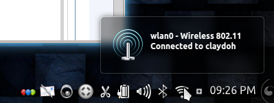

          Do you have a network icon on your system tray? It should look like the icon next to the mouse cursor in the image below:

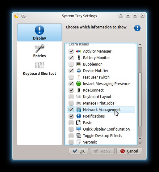

          If it is there, you can just click the icon to see your network connections, where you can edit them, etc. If it is not there, click the arrow at the right side of the system tray (just to the right of the mouse cursor in the above image) to see if it is hidden for some reason. If it is not there at all, right-click on that arrow, select "System Tray Settings" and make sure that the Network Management widget is enabled:

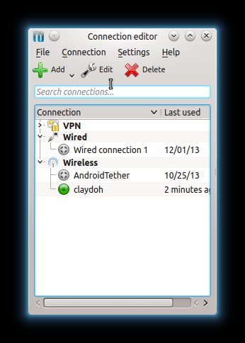

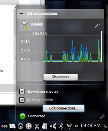

          Here is more of what it should look like:
            Thanks. I think you showed me what I needed to see. I had found several discussions about this new "network plasma widget", but I kept thinking... "That's not what I need, I want to edit the connections, not just check their status.".
            So I was digging around in there before writing back to say "Nope, still no editing." when sure enough, there's a little gray wrench icon. Which of course displays more status information, and then an "Edit Connection" button. And when you press the edit connection button, the control panel I've been looking for all along is there.

                Thanks for yet more picture claydoh. They've helped some more. I don't have a button that says "Edit connections" like you do. Or rather I didn't think that I did. Turns out the wrench next to the "Connected" with the with the green dot edits the uhh... "connected" I guess. Once I've clicked on that wrench the "Edit Connections" button appears, which turn opens a window that will allow me to add connections.
