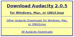

                    I followed the link you gave to see
                    I clicked the main download link and got "audacity-minsrc-2.0.5.tar.xz". That's a source tarball; you're then expected to compile it. (Strictly, build it, which in general may or may not involve compiling, but in audacity's case it's a shed-load of compiling.) Like most linux software projects, it's been built with Gnu autotools, so I followed generic compile and install instructions. In a konsole, some preparation:
