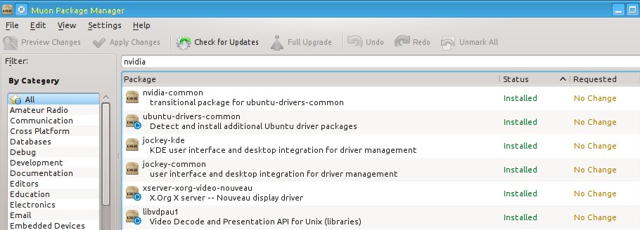

                    and it gave multiple listings of my sound card. I selected all possibilities and nothing came out of the TV speakers. The video card that I have is the NVIDIA GeForce GT 630M 2GB and for this I have the default packages installed, nvidia-common, ubuntu-drivers-common, jockey-kde, jockey-common, xserver-xorg-video-nouveau, libvdpau1
                    I hope the kernel drivers for this video card come out soon. Thanks for your suggestions which have given me more insight into this problem.

                      I can certainly understand what you are saying. Could you please let me know what NVIDIA card you have and what drivers you have installed. To illustrate, I used muon and entered nvidia in the search box and clicked twice on "Status" to show the installed packages that are listed in the graphic below.
