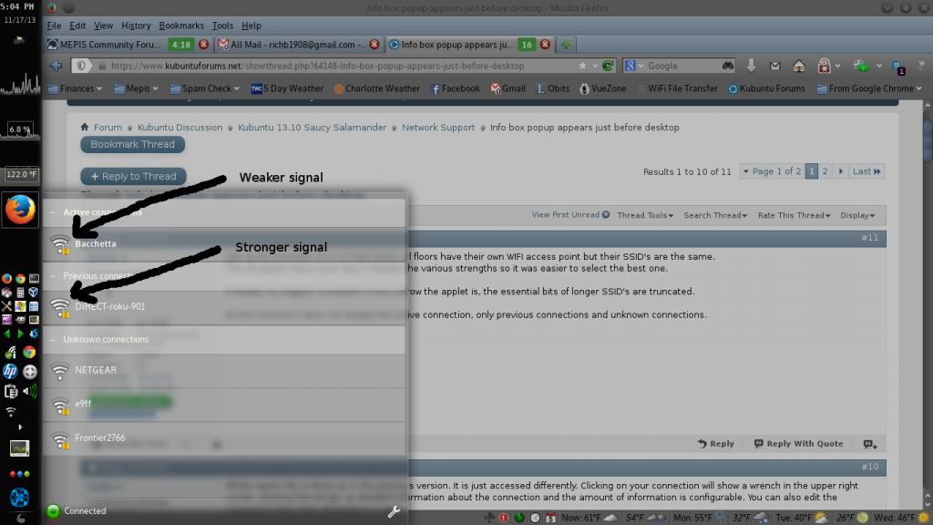

                    Originally posted by Teunis
                    Probably my biggest complaint is how narrow the applet is, the essential bits of longer SSID's are truncated.
                    With it open, just click+drag one of the corners to size it.
                      This is what mine looks like. The signal strength is shown by the number of bars. Visibility may depend on the style chosen. Of course in this case the SSID's are different.
