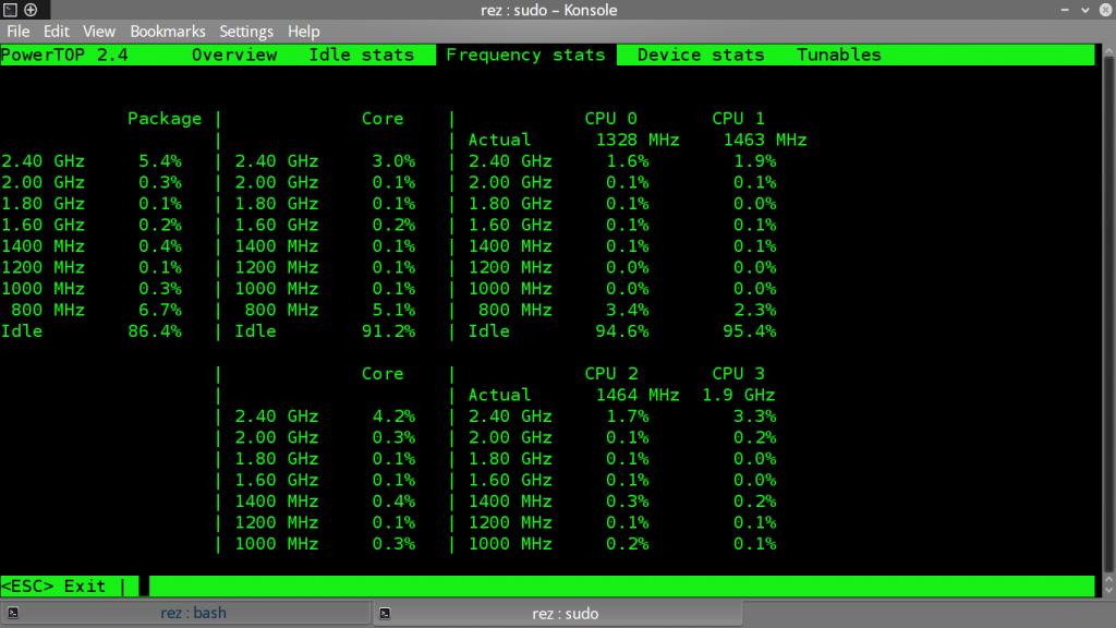

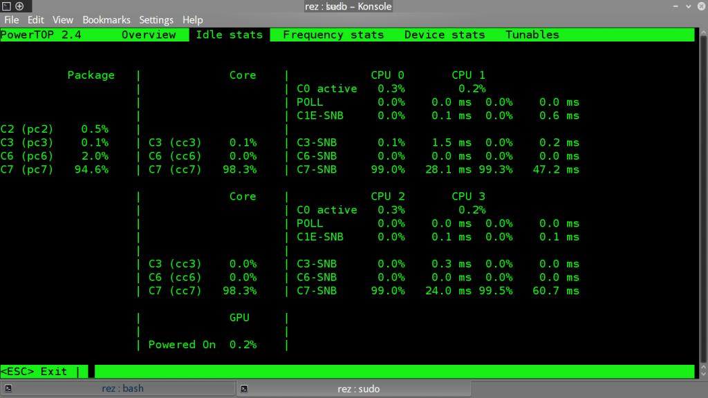

    Install powertop and observe the "Idle stats" tab. Your cores should be sleeping in C7 for over 90% of the time. What do you observe?
    What are your current kernel boot parameters? Try adding idle=mwait and see if that makes a difference.
      Instead of telling you is it OK if I attach screens of the 2 state related tabs from powertop? Here they are

        Those screenshots look fine.
        It appears that a power regression has snunk into the kernel, starting with 3.10 (info, more info). Adding idle=mwait is reported to help. Also, you should remove the acpi_osi=Linux parameter. Some especially buggy firmwares will shut down features if they detect Linux is booting; without that parameter, Linux fakes itself as Windows to the firmware so that all features remain available.
