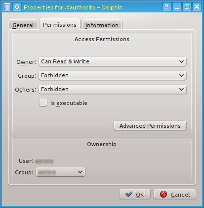

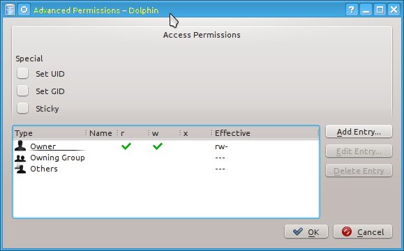

                            I have never had .Xauthority owned by root. The ownership was the first aspect that I checked when trying to resolve the problem. In all cases, it was owned by Username. The attached graphics show the permissions and the advanced permissions on the file create at login.
