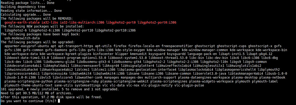

I have been holding off upgrading for two days as many important packages would be removed. The attached image illustrates what I got this morning. I decided to install the updates but Google Earth no longer works and cannot be installed. When I try an autoremove I get a long list of 32B packages that should be removed. Has anyone else had this problem?

I'm going to guess that apt-get's solver encountered something it couldn't figure out. I would have tried a few other things first:
1. apt-get upgrade, which only upgrades packages in place; then followed by apt-get dist-upgrade. This can sometimes avoid confusing cross-dependency resolution.
2. aptitude update && aptitude full-upgrade and observe the differences before committing. Aptitude's solver employs a slightly different algorithm that handles weird cross-dependency issues differently. Sometimes it's better, sometimes not.
However...you've already done the upgrade, and now stuff's broke. Go ahead and run autoremove. Then try reinstalling Google Earth. If it fails, please copy-pasta the output here so we can take a look.

Hi Steve,Originally posted by SteveRiley View PostI'm going to guess that apt-get's solver encountered something it couldn't figure out. I would have tried a few other things first:
I always use apt-get upgrade and apt-get dist-upgrade so that I do not get caught with muon doing something that I do not approve off. I did try aptitude and got a similar resultI then responded to this action with "n" and got the following responseCode:aurora@basil:~$ sudo aptitude dist-upgrade The following NEW packages will be installed: libgphoto2-6{a} libgphoto2-6:i386{a} libgphoto2-port10{ab} libgphoto2-port10:i386{ab} The following packages will be upgraded: apparmor-easyprof-ubuntu apt apt-transport-https apt-utils freespacenotifier ghostscript ghostscript-cups ghostscript-x gvfs gvfs:i386 gvfs-common gvfs-daemons gvfs-libs gvfs-libs:i386 kamera kde-style-oxygen kde-window-manager kde-window-manager-common kde-workspace kde-workspace-bin kde-workspace-data kde-workspace-kgreet-plugins kinfocenter klipper kmenuedit ksysguard ksysguardd language-pack-en language-pack-kde-en libapt-inst1.5 libapt-pkg4.12 libboost-date-time1.53.0 libboost-program-options1.53.0 libboost-system1.53.0 libboost-thread1.53.0 libdbusmenu-glib4 libdbusmenu-gtk3-4 libdbusmenu-gtk4 libglibmm-2.4-1c2a libgphoto2-2 libgphoto2-2:i386 libgphoto2-l10n libgs9 libgs9-common libkdecorations4abi1 libkephal4abi1 libkscreensaver5 libksgrd4 libksignalplotter4 libkwineffects1abi4 libkwinglesutils1 libkwinglutils1abi2 libkworkspace4abi2 libplasma-geolocation-interface4 libplasmaclock4abi4 libplasmagenericshell4 libplymouth2 libprocesscore4abi1 libprocessui4a libsane libsane:i386 libsane-common libtaskmanager4abi4 libusb-1.0-0 libusb-1.0-0:i386 libvlc5 libvlccore5 libweather-ion6 manpages manpages-dev plasma-dataengines-workspace plasma-desktop plasma-netbook plasma-scriptengine-python plasma-scriptengine-ruby plasma-scriptengine-webkit plasma-scriptengines plasma-widgets-workspace plymouth plymouth-label plymouth-theme-ubuntu-text sane-utils systemsettings vlc vlc-data vlc-nox vlc-plugin-notify vlc-plugin-pulse 88 packages upgraded, 4 newly installed, 0 to remove and 0 not upgraded. Need to get 44.9 MB of archives. After unpacking 2,611 kB will be used. The following packages have unmet dependencies: libgphoto2-port0 : Conflicts: libgphoto2port which is a virtual package. Conflicts: libgphoto2port:i386 which is a virtual package. libgphoto2-port0:i386 : Conflicts: libgphoto2port which is a virtual package. Conflicts: libgphoto2port:i386 which is a virtual package. libgphoto2-port10 : Conflicts: libgphoto2port which is a virtual package. Conflicts: libgphoto2port:i386 which is a virtual package. libgphoto2-port10:i386 : Conflicts: libgphoto2port which is a virtual package. Conflicts: libgphoto2port:i386 which is a virtual package. The following actions will resolve these dependencies: Remove the following packages: 1) google-earth-stable 2) ia32-libs 3) ia32-libs-multiarch:i386 4) libgphoto2-port0 5) libgphoto2-port0:i386I did this on my Laptop which I had not accepted the full-upgrade. I was wondering if my problems were caused by having pre-release updates selected. For the above, I de-selected that option before using apt-get and aptitude.Code:Accept this solution? [Y/n/q/?] n The following actions will resolve these dependencies: Remove the following packages: 1) colord 2) google-earth-stable 3) hplip 4) ia32-libs 5) ia32-libs-multiarch:i386 6) kamera 7) libgphoto2-2 8) libgphoto2-2:i386 9) libksane0 10) libsane 11) libsane:i386 12) printer-driver-postscript-hp 13) sane-utils 14) skanlite Keep the following packages at their current version: 15) libgphoto2-6 [Not Installed] 16) libgphoto2-6:i386 [Not Installed] 17) libgphoto2-port10 [Not Installed] 18) libgphoto2-port10:i386 [Not Installed] Leave the following dependencies unresolved: 19) cups recommends colord 20) cups-daemon recommends colord 21) cups-filters recommends colord 22) foomatic-filters recommends colord 23) ghostscript-cups recommends colord 24) libcolord1 recommends colord 25) libsane-hpaio recommends sane-utils 26) libsane-hpaio recommends hplip (= 3.13.4-1build1) 27) gwenview recommends kamera 28) kubuntu-desktop recommends hplip 29) kubuntu-desktop recommends kamera 30) kubuntu-desktop recommends skanlite Accept this solution? [Y/n/q/?] q Abandoning all efforts to resolve these dependencies. Abort.

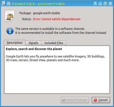

On my other "sacrifical" desktop I tried to install Google Earth after doing the autoremove and the response I got is shown in the attached imageOriginally posted by SteveRiley View PostHowever...you've already done the upgrade, and now stuff's broke. Go ahead and run autoremove. Then try reinstalling Google Earth. If it fails, please copy-pasta the output here so we can take a look.

Aha, I think adamsojc might be on to something. https://launchpad.net/ubuntu/+source/libgphoto2 tells us that libgphoto2-2 is now a transitional package for libgphoto2-6. Furthermore, libgphoto2-port0 is no longer present, but instead we see libgphoto2-port10.
I'm not sure this has anything to do with backports -- is that repository even enabled for Saucy yet, which is what we're dealing with here in this post? Instead, these new packages are part of the base Saucy release as of today.

Your currently-installed libgphoto2-2 is version 2.4.14-2.3ubuntu1. The to-be-installed version is 2.5.2-0ubuntu2, which is an empty transitional package that will pull in its replacement, libgphoto2-6.
This replacement declares that it will break any version of libgphoto2-2 less than version 2.5.2. Therefore, APT will remove the currently-installed libgphoto2-2 package, since its version falls within the breakage declaration.
Saucy appears to be in the midst of updating these and other libraries. It's to be expected that third-party packages like Google Earth will break when this sort of thing happens, especially if their dependencies are poorly defined. The only recommendation I can make is for you to uninstall Google Earth, perform a dist-upgrade, and then try reinstalling it.

Because I removed libgphoto2-2 I get the following:When I did an installation of google-earth-stable_6.0.3.2197-r0_amd64.deb I get the following:Code::~$ apt-cache policy libgphoto2-2 libgphoto2-2: Installed: (none) Candidate: 2.5.2-0ubuntu2 Version table: 2.5.2-0ubuntu2 0 500 http://archive.ubuntu.com/ubuntu/ saucy/main amd64 Packages :~$ dpkg -L libgphoto2-2 dpkg-query: package 'libgphoto2-2' is not installed Use dpkg --info (= dpkg-deb --info) to examine archive files, and dpkg --contents (= dpkg-deb --contents) to list their contents. :~$It seems to be wanting the ia32-libs package which is no longer available on my system.Code::~/Update$ sudo dpkg -i google-earth-stable_6.0.3.2197-r0_amd64.deb [sudo] password: Selecting previously unselected package google-earth-stable. (Reading database ... 177736 files and directories currently installed.) Unpacking google-earth-stable (from google-earth-stable_6.0.3.2197-r0_amd64.deb) ... dpkg: dependency problems prevent configuration of google-earth-stable: google-earth-stable depends on ia32-libs; however: Package ia32-libs is not installed. dpkg: error processing google-earth-stable (--install): dependency problems - leaving unconfigured Processing triggers for man-db ... Processing triggers for desktop-file-utils ... Processing triggers for mime-support ... Errors were encountered while processing: google-earth-stable :~/Update$

Yes, ia32-libs has been slated to be removed for some time, and it finally was on 1 August. Google will need to update their package so that it no longer has a hard dependency on that.
