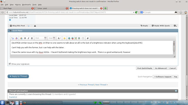

                I have the same issue with my Asus X202e. I haven't bothered making the brightness keys work because thiere is such a good workaround. I have two simple one-line scripts attached to two green arrow icons on the bottom of the screen. One brightens by 20% increments, the other dims in 20% increments. xbacklight is a package that has to be installed, but it is in the repos.
                xbacklight -dec 20
                xbacklight -inc 20
                If you want to try this, install xbacklight, run one or both of the commands above in a terminal, and make sure it works. Not all machines respond to xbacklight.
                I've added the reduced size screenshot so that you can see the two green triangle icons that I use to control this.
                Hope that helps.
