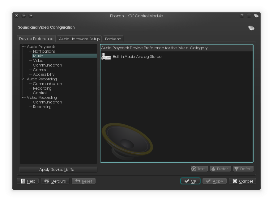

    Also...please press Alt+F2, enter phonon, and post a screen capture of the resulting dialog box.

      Here is the result of the phonon command. Doesn't seem to show much...
        It looks correct. Sometimes you'll see "PulseAudio Sound Server" as the lone object in that list; when you do, it means that the script that hooks PulseAudio to KDE didn't run. It's easy to fix that, just press Alt+F2 and run start-pulseaudio-kde.
