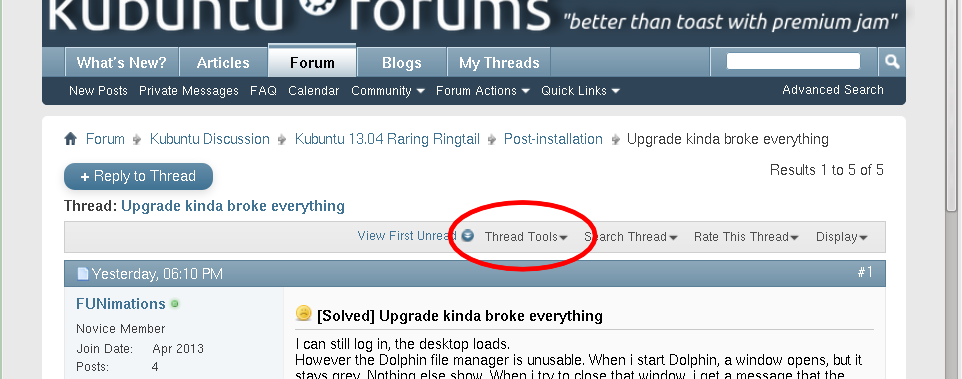

            Search for a solution first. I'm sure your problem has been addressed in some of the recent threads concerning Skype. If you have a unique issue then start your own thread. Please mark this thread SOLVED.
