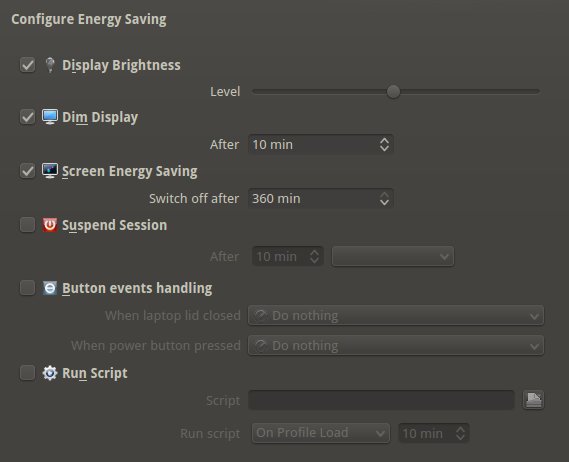

    My system settings for power management are as shown in the attachment.
