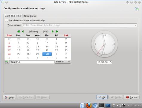

          Kubuntu 12.10, KDE 4.10.0, digital clock widget is working perfectly here. Timezone (right-click > Adjust Date & Time) is set to New York and it is showing the correct local time for the Eastern Timezone.
