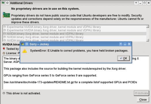

    What are the magic spells to fix the following problem:
    The original problem I'm trying to fix is some sort of codec problem in vlc, dragonplayer, xine, etc.:eek:
    All the colors are shifted to the blue part of the spectrum. The only area that was changed was the NVidia
    driver(s).
    Try this first:
    sudo apt-get update
    sudo apt-get install -f
    sudo apt-get dist-upgrade
    sudo apt-get install kubuntu-desktop
      Thanks, but apparently blacklisting nouveau and nvidia, reinstalling some things, etc. seems to have fixed the
      problem, along with restoring the codecs to decoding videos in the proper color-ranges also.
      This problem(s) is [SOLVED].
