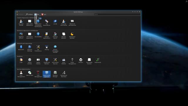

    I have been attempting to figure out a strange problem I have been having on my laptop. I just switched from Ubuntu to kubuntu as I did not care for unity and am having a strange error that I don't even know where to start looking to fix the problem.
    I am using an Aleinware M17x r4. I have installed bumblebee to enable optima so that I may use the intel gpu instead of the dedicated nvidia card as it is not very power efficient.
    I have tried all the scale methods possible.
    Any help would be much appreciated.
    Try setting Qt graphics system: to Native and uncheck Use VSync.
      Unfortunately that did not fix the issue.
        In the All Effects tab, if Blur is checked, uncheck it.
          Sadly again, no dice. Still has the weird effect. It is doing it in not just there but pretty much everywhere at random. Sometimes it is there sometimes it isn't. Is there a way I could find a driver log or something to help you guys?

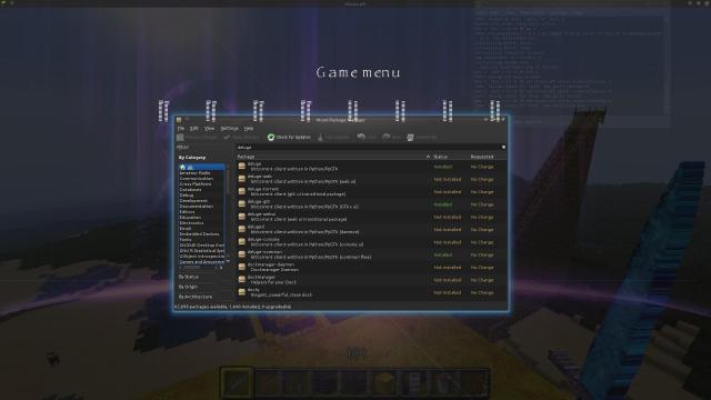

          Another example of the strange behavior.

              I have tried xrender and it does seem to fix the problem. However I cannot change back to openGL now as it is having an error and reverting back to xrender.
              Update it did not fix all of the issues.
                The problem is due to this bug:
                https://bugs.launchpad.net/ubuntu/+s...a/+bug/1061073
                I went back to 12.04 to get the Mesa 8.0.4 libraries, and then used the Kubuntu PPA to get KDE 4.9.2 so that I could run *almost * what's in 12.10. It looks like the KDE guys fixed the bug; I think at this point all we're waiting for for the Kubuntu guys to apply the patch and give us a KWin update.
