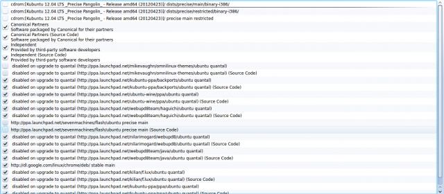

Replace KDM over lightdm
http://i.imgur.com/2YEVc.png
the log is:
Code:~$ sudo apt-get install kdm=4:4.9.3-0ubuntu0.1~ppa2 Reading package lists... Done Building dependency tree Reading state information... Done Some packages could not be installed. This may mean that you have requested an impossible situation or if you are using the unstable distribution that some required packages have not yet been created or been moved out of Incoming. The following information may help to resolve the situation: The following packages have unmet dependencies: kdm : Depends: libkworkspace4abi2 (= 4:4.9.3-0ubuntu0.1~ppa2) but 4:4.9.3-0ubuntu1~ubuntu12.04.1~ppa3 is to be installed Depends: kde-workspace-kgreet-plugins (= 4:4.9.3-0ubuntu0.1~ppa2) but 4:4.9.3-0ubuntu1~ubuntu12.04.1~ppa3 is to be installed E: Unable to correct problems, you have held broken packages.
