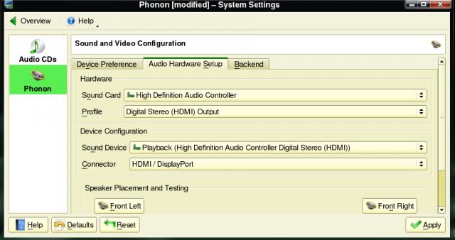

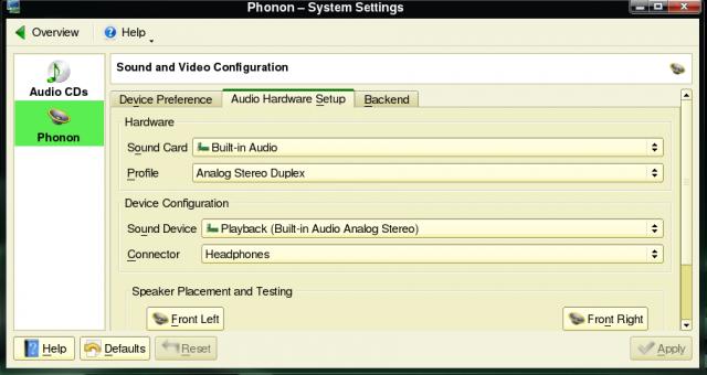

                  But one thing is still there: The bad sound. And it looks like the system settings store the settings only during the session. After restart the settings are lost. Please have a look at the picture "Selection_001.png". These are the standard settings. But I need the settings as shown in picture "Selection_002". So, what can I do to keep the settings for Phonon?
