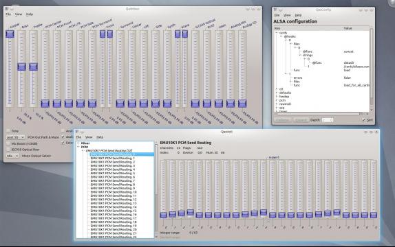

    As for the mixer, the mixer at all, rather than a kmix, this really works nicely >> QasTools
      Interesting...does QasTools allow you to direct sound from different sources (programs) to different sinks (outputs)?
        Yes. I believe that's "QasHctl" part of package, a mixer/channel router for ALSA's more complex "High level Control Interface", however, I still didn't played with, as I don't need that. All I need is stable web dev/design machine that can provide high-quality stereo sound output while I am working.
