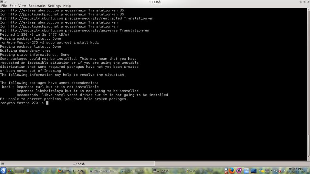

      This is exactly what I did ... and got nothing eventually

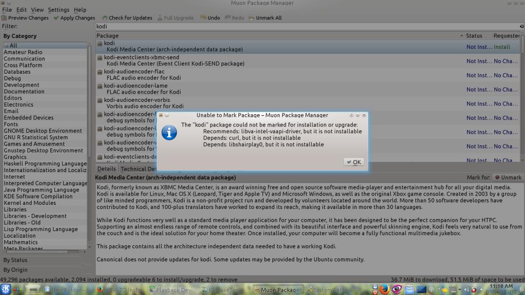

        This is what I get when i try to install kodi

          kodi: Depends curl but it is not installable.
          What is the cause of this ?
          Try to install the 'curl'
          What is the error ?
            I might suggest running apt-get update (again ) to see if there is/was a temp issue with the repos - the libshairplay0 package is available in the kodi ppa, and curl most definitely is available, as is the intel vaapi driver, in the official ubuntu repos.
            If this persists, try
            sudo apt-get -f install , this may pull in those missing bits.

              ron@ron-Vostro-270:~$ sudo apt-get install kodi
              Reading package lists... Done
              Building dependency tree
              Some packages could not be installed. This may mean that you have
              requested an impossible situation or if you are using the unstable
              distribution that some required packages have not yet been created
              or been moved out of Incoming.
              The following information may help to resolve the situation:
              kodi : Depends: curl but it is not installable
              Depends: libshairplay0 but it is not going to be installed
              Recommends: libva-intel-vaapi-driver but it is not going to be installed
              E: Unable to correct problems, you have held broken packages.

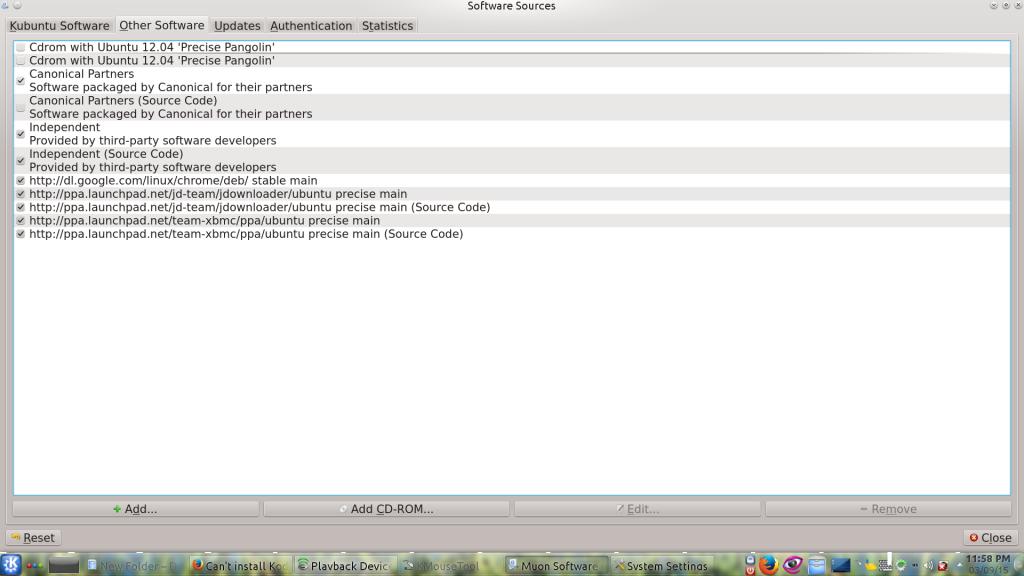

                    Could you list any ppas you have installed in addition to the xbmc one?
                      do you mean other ppas I have ?
                      I have JDownloader and Google Chrome PPAs installed

                          It seems like I have a bigger problem here. I tried to install PPA-Purge from Muon and this is the message I got
