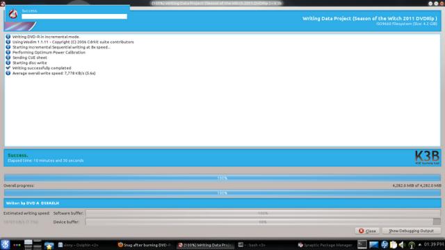

              Well yes I have NO problem's with this ..........I just burned 4.2Gig's of data (vids)as a data project on a Maxell-4.7GB-data-DVD-R without any problem and upon reinsertion in to the drive the device notifier popes up giving me the expected options ........however clicking the open in file manager did nothing .....but opening dolphin and clicking the disk in the places panel opens the disk and all vid's are playable .
