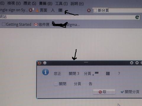

    I installed Kubuntu 12.04 on my laptop (Acer TravelMate 6292) and there's a problem that upset me very much.
    After running for a while, no more than one hour, sometime it would happen in ten minutes,
    my desktop would start to have broken image, just like the attached image.

      In the attached image, you can see that the words in the dialog was missing. In the tab bar also words missing. In the upper right corner of the dialog you can see abnormal icons there. In the upper right corner the google search bar was not correct either. Actually there are more but I couldn't take snapshot when it went wrong. I just used my smart phone to take photos like that.

                    BTW, when things went wrong I tried to logout the session. I couldn't see the logout prompt but it was actually there, and if I blindly clicked the position I could log out, and everything went back to normal after X server restarted.
