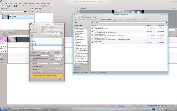

    I can not get kdenlive to render in for exmaple mpeg4 format. It says it is missing a library but i do not see what is missing. i even installed a -dev library. (see attached picture). What do i need to render videos in other formats?

    Do you have the kubuntu-restricted-extras package installed? If not, install it and try again. I can encode into many formats with KDEnlive.

            You still may need to install other libraries and tools, the warnings will tell you where to start. Installing -dev packages is for compiling and development.
            Search Muon for libavcodec53, libmp3lame, h264enc and possibly libx264-120. That should pull in what you need.
              Also, you will have to re-run the setup wizard. If that does not show mp4, mp3, h264 in the codecs/formats section there you will have to close kdenlive, delete your kdenlive config file /home/<your-username>/.kde/chare/config/kdenliverc, and run the program again, forcing the wizard to be fun fresh.
                been dealing with other more important issues. anyway tried all of the above. installed everything as mentioned. reconfigured kdenlive as mentioned but i still get the same message about unsuported codec. i did get more options, but most of them have a message about unsuported library or codec.

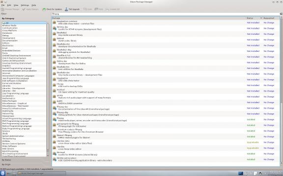

                      do have FFMPEG installed kdenlive uses it to do it's transcoding ?
                        The following ffmpeg stuff is installed (see attached pic) or here: http://ubuntuone.com/2VQfvqngtq778qwgWiITER
                        i am not sure if any extra things need to be installed here.
                        at the moment it certainly looks like kdenlive is broken.
