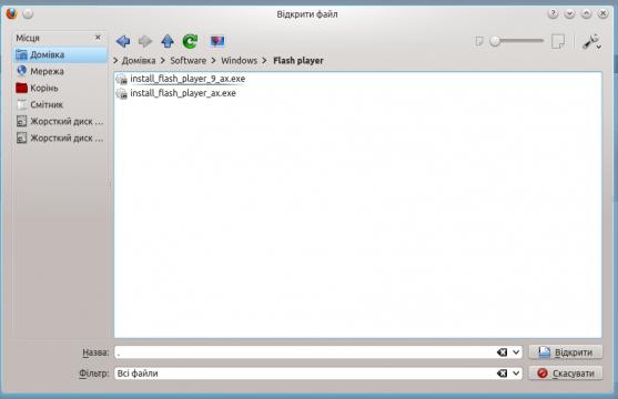

                Not sure.
                With firefox-kde-support installed I see for open file:
                It's differ from your image.

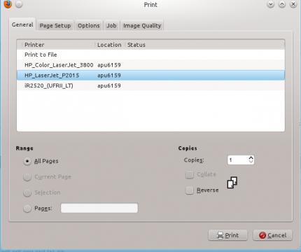

                My print dialog is:
                I think this is not KDE style.

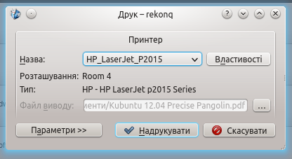

                E.g. for Rekonq dialog I see following:
