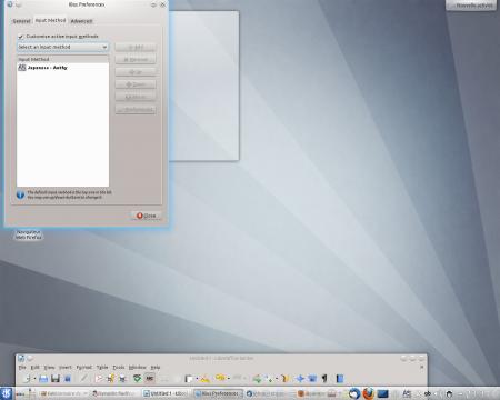

                            When you are in the Ibus Preferences Window, in the Input Method tab, scroll in Select an input methods, click on Japanese (even if it looks grey) and you should see Japanese-Anthy,
Name:	capture d'écran2.jpg
                              You need actually to click on the sign '>' in the '> Japanese' grey submenu of 'Select an Input methods' to make Japanese-Anthy appear.
                              Clicking on 'Japanese' does not work
