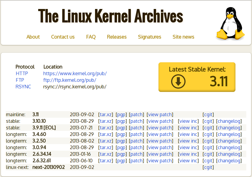

                      Not to sidetrack this thread, but "since I booted up the 3.8.52 kernel"
                      Your running 12.04; I'm on 13.04. Why isn't there a 3.8 kernel (above)?

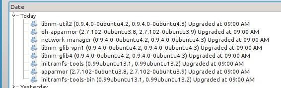

                              My system has been running fantastic since I did the purge and reinstall of nvidia, bumblebee, primus and dmks apps. I was getting 300 frames/sec and NO network disconnects. The Internet connection was the fastest its been in months.
                              At 9 AM an update notice came. I clicked on it and not 60 seconds after it was done my network connection broke. I ran
                              sudo service network-manager restart
                              and it started right back up, but broke within a minute. Rinse and repeat. (There isn't an animated icon which appropriately expresses my anger right now.)
                              Now I can't get any faster than 200 frames/sec. But, Internet speed is OK and the eth0 connection seems stable. Time will tell.
                              I started up muon and checked the history to see what was updated. Then I reverted as many as I could to the previous version. Top on the list was network-manager. I've attached a graphic showing what was upgraded and those files which I could downgrade. Muon wouldn't let me revert them all. I need to find the apt command that allows me to specifically revert to the previously installed package. Either that, or reinstall 12.04 from the latest ISO.
