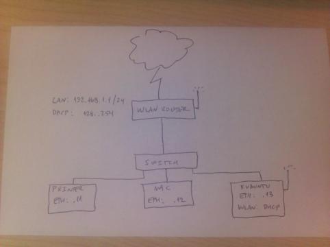

                        I think we should take a step back here and reconsider your network architecture, I would recommend simplifying it so that you're using only a single subnet and not have to worry about configuring routing. I realize that what you have "just worked" with Mepis, but I suspect that there's probably a more elegant way to design your network.
                        I presume the device labeled "wireless" also manages your connection to the Internet, correct? If so, then with a slight redesign and renumbering, we can make some improvements. But before I suggest anything, it would be good to have an answer to my question.
                          Yes wireless is a DSL wireless modem.
                          Michel
                            I would recommend you simplify your network as diagrammed in the attachment. There's really no need to dual-home the Mac or try to get routing running on your Kubuntu machine. My suggested changes:
                            • Use a single subnet, 192.168.1/24 ("/24" means subnet mask 255.255.255.0)
                            • Configure the LAN side IP address of your wireless router to 192.168.1.1/24
                            • Set the DCHP range to begin with 192.168.1.128 and end with 192.168.1.254
                            • Connect the switch to the router
                            • Connect the Ethernet port on the printer to the switch, use the static address 192.168.1.11/24
                            • Connect one Ethernet port on the Mac to the switch, use the static address 192.168.1.12/24
                            • Don't use the other Ethernet port on the Mac
                            • Connect the Ethernet port on the Kubuntu box to the switch, use the static address 192.168.1.13/24
                            • Configure the wireless interface on the Kubuntu box to use DHCP
                            Both computers will see the printer, the computers will see each other, and the Kubuntu box can easily move between wired and wireless.
