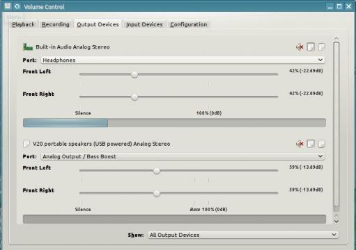

        I assume that you are using Pulseaudio and you could install pavucontrol and this should show your USB speakers. Make sure that it is not muted. There are three buttons as shown in the attached graphic, and only the centre one should be depressed.
        You could also click on the speaker icon and select Mixer and make sure that your USB speakers are not muted there. I hope that either or both of these approaches work for you.
