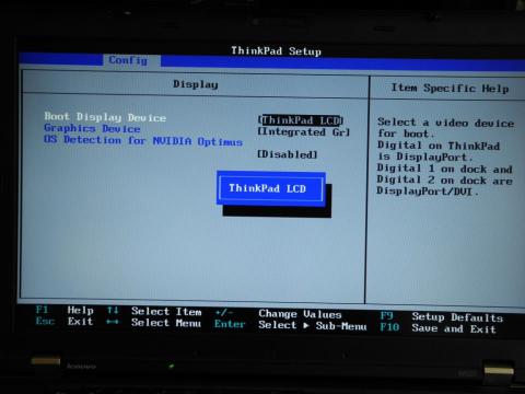

            My T520...
            Config menu:
            Display section:
            Boot choice:
              Thanks Steve, your last picture shows where our computers differ.

                That appears almost intentional, perhaps a way to justify charging a higher price for the W520?

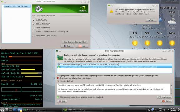

                        Attached is a screen shot taken after booting with the Discrete Graphics settings.
                        It shows how the NVIDIA X Server Settings do not find a driver and Jockey showing the driver installed but not in use.
                        Only when I install the other driver (or reinstall) and restart X I get full control.
                        Would I reboot I get back to the shown situation.
                        Maybe there is an other way to 'bump start' the installed but not in use NVIDIA driver?

                          You've encountered the same problem I described in post #2 in this thread. I gave up on trying to get nVidia to work on my T520. The open-source drivers don't fully exercise the capabilities of the chip, and the binary driver replaces too much of the kernel for my taste.
                            Yes it is the same problem, at least I get around it by reinstalling and restarting the nVIDIA module.
