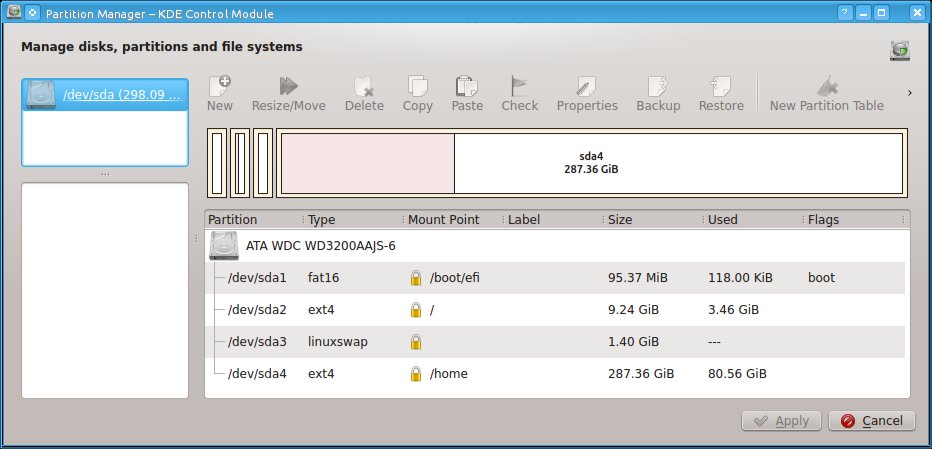

        When I started the installation process for the 27th March iso image, my system for the first time gave the option:
        UEFI Sources
        >UEFI: SanDisk
        This indicated to me that the UEFI problem could have been solved.
        Previously, to overcome the problems that I was having with UEFI not working, I had created a /DOS partition for a 21st March build and that seemed to solve the problem then. When I used the 27th March build, I was given the option to use the space I had previously use for the /DOS partition to make it an efi partition. My partitions are shown in the graphic. I was overly generous with the /boot/efi partition and I keep my linuxswap partition between the system and home partitions to minimize disk access times when tasks are swapped out of RAM.
        I will be interested to know if you also have success with the current iso image.
