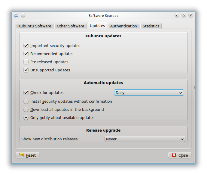

    Muon > Settings > Configure Software Sources > Updates > Check for updates: Daily (and I choose to mark Only notify about available updates with New Release upgrade > Show new distribution updates set to Never)

      Thanks. Those are my exact current settings, but I haven't seen any notifications about software updates.
      Just opened Muon Package manager and the bar at the bottom says I have a few upgradable packages - just did the apt-get update yesterday.
