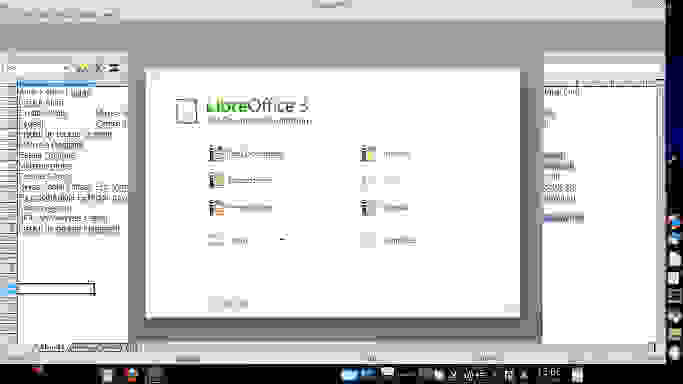

    Okay, I haven't used my Laptop for any printing until lately.
    When Printing (HP Color Laser 1600) a few weird things happen.
    Numbers and some letters come out completely scrambled and or are not rendered correctly.
    Also when I close a window (doc or spreadsheet) I get a strange screen with the closed document in the background and and middle part of the libreoffice main window in the foreground.
    I am trying to describe this as clearly as possible

      Re: Weird stuff from LibreOffice
      Could be this?
      http://askubuntu.com/questions/68909...vo/70692#70692
      I had strange characters in my prints when printing from Libreoffice after upgrading from Kubuntu 11.04 to 11.10. Following the above solution solved my problem. Maybe yours to?
        Great thank you, that solved the printing issue.
        Now for that weird background
        Tried deleting .libreoffice from /home but that didn't help.
            Just to confirm that the libreoffice background problem happened to me last night for the first time.
            About 3/4 days ago there was a big KDE download which was presumably an update to 4.7.2. (I didn't have the kubuntu ppa installed until after that). Last night was my first use of LOo since that update so in my own mind I'm linking the 2. Also the desktop appears to have become more "fragile" esp so far as desktop effects are concerned.
                      Originally posted by Fintan
                      Oh, I forgot to mention that the horizontal scroll in calc does not work either
                      I had the same problem with the horizontal scroll not working. Uninstalling libreoffice-style-oxygen and libreoffice-kde "fixed" the problem. Of course Libreoffice now looks like something from last century, but it works.
