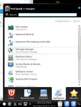

?? Muon Software Center and Muon Package Manager appear under System by default.Originally posted by vw72 View PostI would agree with this. Muon has matured and become very stable. Now if they would only add it to the system settings dialog.Windows no longer obstruct my view.

It does here, on 12.04.Originally posted by vw72 View PostIt does in the classic menu, but using the default menu, the system settings brings up a dialog box and muon doesn appear there.
