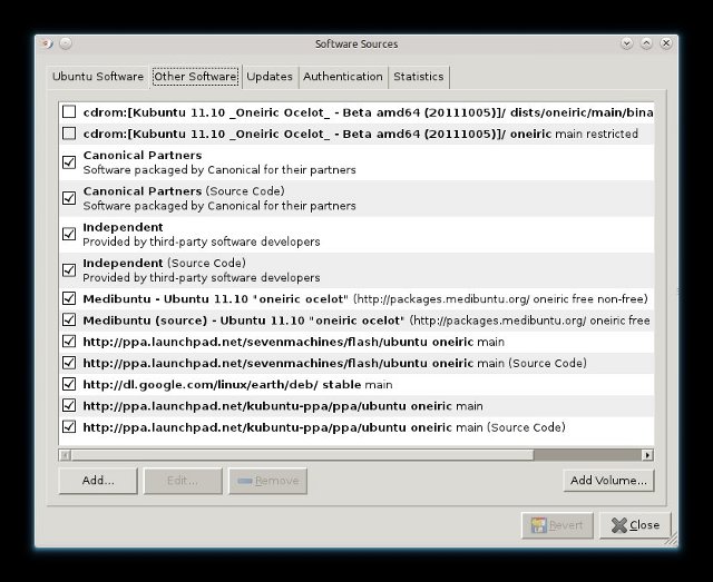

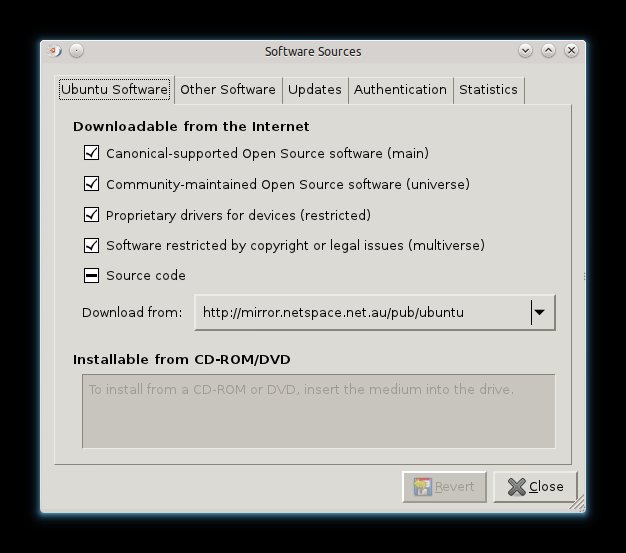

            I must say that I am surprised that you are having so much trouble with 11.10. I have added the software sources and the other software repositories that I have on my system. With Pulse Audio, I hope you have used System Settings > Multimedia > Phonon to set the order in which the Playback and Recording devices are selected. The mixer settings on the volume control can be accessed to make sure that nothing is muted.

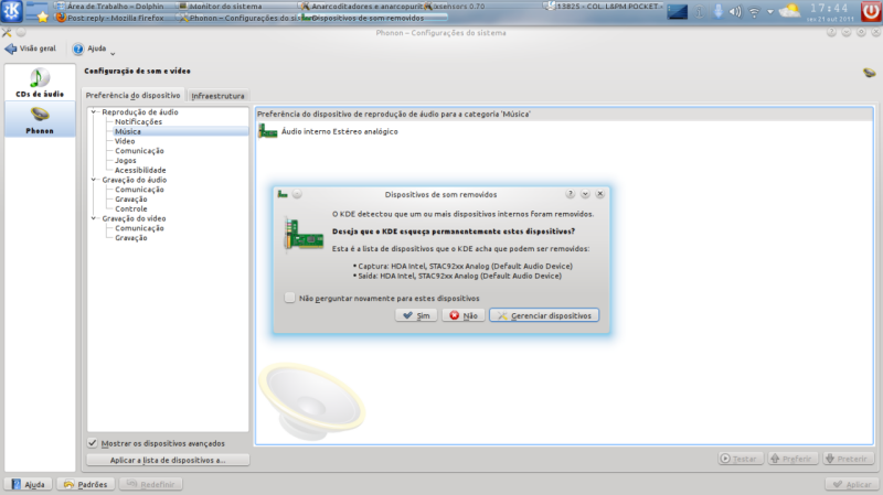

                      For the audio, after the 11.10 upgrade I've got this message saying that KDE detected that components may have been removed. What should I do? I'm having issues with mic sound on Jitsi (people say it's muted), but I've already checked alsamixer and it's not, and I've tested it on a webpage and it's working. Maybe this is related somehow?

                            Hey, thanks for the tip. I'll check that later, but before that, I'd just be glad to know if I should or not confirm that KDE may forget about those devices...
                              Re: is Muon seriously retarded??
                              With my laptop I have usb speakers which I have put as the preferred output device. When these are not plugged in, I used to get the message about removing them. I now have disabled this message so that I do not get it any more. I your case I would not let KDE remove the device and try to see what pavucontol finds. I hope you have success.
