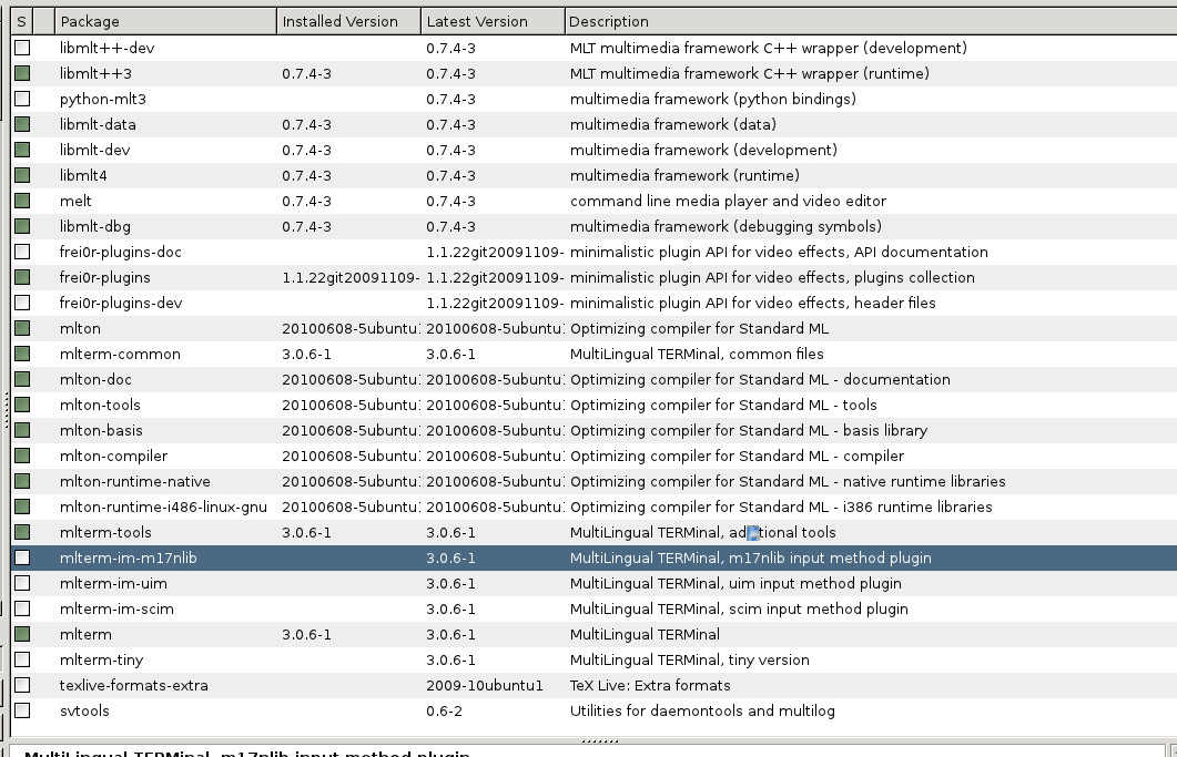

                        Re: Kdenlive MLT error launch
                        here i will attach my mlt libraries
                        so it would seem i have everything i need
