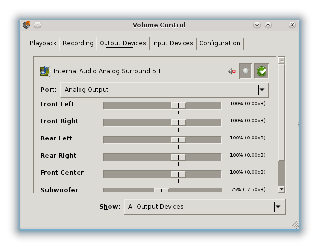

        You *are* right, before one had to use pavucontrol, and I remember having it installed earlier. But, FYI, with 11.10 there is a similar application now available under 'Pulse Audio Volume Control', see attachment. It shows clearly the selected 5.1 output.

          pavucontrol is called "Pulse Audio Volume Control" int he menu, same app.
          It was the
          AO: [pulse] 44100Hz 2ch floatle (4 bytes per sample)
          that got me thinking it might be a pulse config problem.
