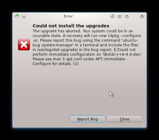

    I'm attaching a screenshot of the error message in case that might suggest something.

      the servers are probably getting quite hammered right now, but you can try different ones to see. I don't know how that relates to the error message you have, though.
        Re: Upgrade fails on desktop and netbook
        Could be a server problem, but from the error message, looks more like an apt problem.
        This might best be diagnosed from a conole.
        Close out the error message, and try running:
        sudo apt-get install -f
        See what error messages it gives. Might be fixable.

              E: Could not perform immediate configuration on 'libstdc++6-4.4-dev'. Please see man 5 apt.conf under APT::Immediate-Configure for details. (2)

                    E: Could not perform immediate configuration on 'libstdc++6-4.5-dev'. Please see man 5 apt.conf under APT::Immediate-Configure for details. (2)

                        I think the real problem is that there are so many packages being upgraded that the resolving algorithm is getting confused.
                        So you could do this again, with
                        sudo apt-get install --reinstall libstdc++6-4.5-dev
                        but I am wondering if you could just remove both 6-4.4 and 6-4.5, as 6-4.6 is going to be installed. The safer way is probably do just to the above, and you might even have to do it with 6-4.6, though that should go through automatically. You can later remove the 4.4 and 4.5 stuff if you want to. Main objective right now is to get the miserable thing to go though at all.
                        Once it quits giving you these errors (should not be more than one more time) then go ahead with the dist-upgrade again.
                        Edit: I should have caught this -- check that packages it says it will remove when you do the dist-upgrade. If c 6-4.4 and 4.5 are among them, then you can go ahead and remove the -dev packages as they aren't needed. I suspect that's why its choking on the dev packages when trying to upgrade.
