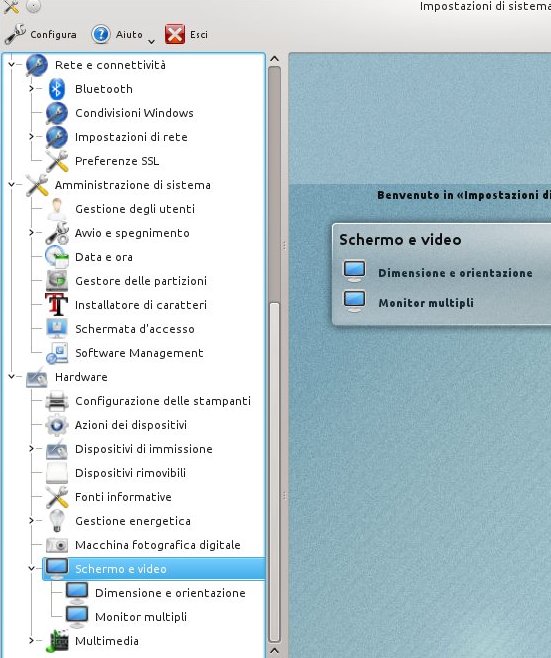

      Hi. Here same problem with screensaver (I'll check a.s.a.p. if both kscreensaver and xscreensaver are running... I'm not at that pc now)
      I upgraded from 11.04 to 11.10b2 and now I've done every update released.
      In kinfocenter I can't find the kscreensaver's configurations' page... does anyone know where it is
      I looked at kscreensaver.rc (or something like this ) but it has nothing about my conf (slideshow from a specific folder etc.)

            The screensaver configuration page has been moved from where it used to be:
            System Settings > Display and Monitor > Screen Saver

                    my systemsettings continues to be without screensaver!!!

                        Yes Calgarian! Same impression here... but I've also the problem with screensaver in systemsettings
                        I made a test with a new user just created: kslideshow.kss is the same, but I can see screensaver's settings in systemsettings...
                        Now I'll try to disable some repo...
                        by the way: systemsettings changed when I added http://ppa.launchpad.net/kubuntu-active/ppa/ubuntu/
