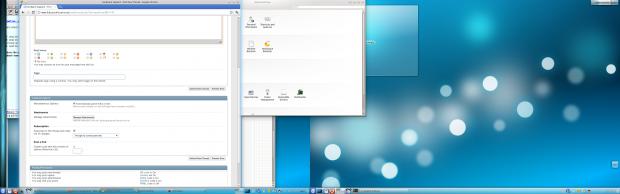

    So I attach two monitors (both Dell P2210) to my Dell Latitude E6520 (Graphics Card: Intel® HD Graphics 3000) running Kubuntu 11.10. I'm having this weird issue. kubuntu seems to recognize the monitors. However the area that would normally be on the laptop's screen is also present. It is squished to the far left side. It seems to be a separate zone as windows are cut off as they enter it. Also I am unable to set a different background per monitor. Finally there are two "New Activity" buttons at the top of the far right screen.
    Attached is a screenshot of my desktop. Please someone help.

    Hi
    I can't see clearly what's going on - could you perhaps post a larger copy of the screenshot - and perhaps with some marks on it to show where the "squished to the far left side" part is, etc?
    What does KDE think you have, at System Settings > Monitor and Display > Size & Orientation? What do you get when you click "Identify Outputs" on that settings screen? - And when you click "Identify all displays" on the Multiple Monitors settings screen?
