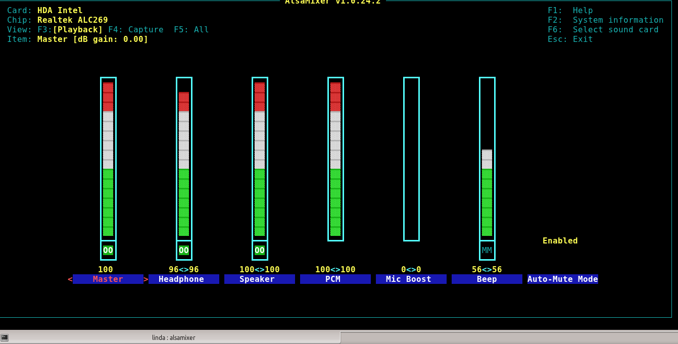

                      Re: sound card does not work after upgrading to Oneiric.
                      this is how alsamixer looks like...(attachment)
                      I dont think there is any problem with that.
                      p.s: my amarok do not have any sounds again after a restart...
                      Cheers, -Linda
                        whats "auto mute mode"?
                        (top of thread: thread tools)
                          no idea...
                          but anyway i disabled it and reboot.
                          no difference.
                          Cheers, -Linda
