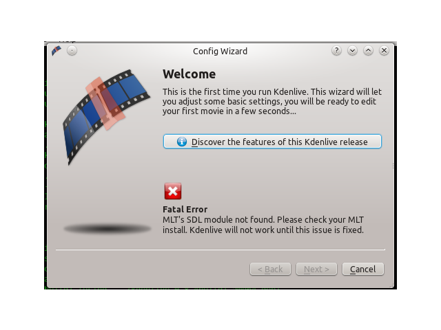

        Tried to install again and getting same error.
        Attached is a link to the error screen so you can see what it looks like
        Thanks!
        Joe
