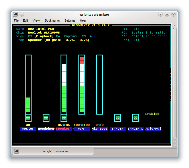

    In the process of trying to figure out what the heck was going on, I fired up alsamixer.
    The attachment alsamixer-no-headphone.png (first thumbnail) is what the mixer looks like when there is no headphone attached. In this example I'm playing music at a fairly low volume level but it's still coming out of the laptop speakers pretty clearly.

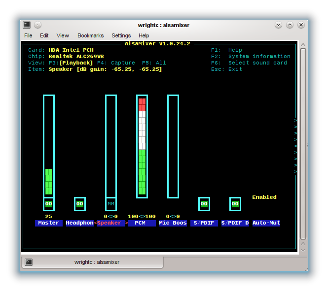

    Then I plugged in my headphones. Immediately the sound cut off. The attachment alsamixer-yes-headphone.png (second thumbnail) is what the miser looks like with the headphone attached. You'll notice the Speaker channel is set to 0<>0.
    When I increased the volume on the Speaker channel in alsamixer, sound started coming through my headphones. Which is good! That's what I want! The sound came through the headphones and not the speakers -- so obviously alsa and the laptop are mostly working correctly, in that when I plug in a pair of headphones into the headphone jack, the sound goes to the headphones instead of the speakers. However, for some reason, each time I do this, the headphone volume cuts off.

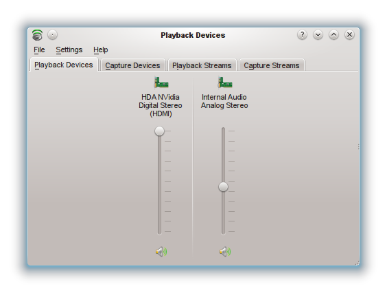

    Now... this wouldn't be a hassle, if it weren't for kmixer and pulseaudio. When PulseAudio is running, kMixer doesn't like to display all the channels alsamixer does. In fact, on the Payback Devices tab you only see two channels, as shown in the attachment kmix.png (third thumbnail). And the "Internal Audio Analog Stereo" channel correlates to the Master channel in alsamixer.
    So my question is... is there a way to keep the speaker channel volume constant when switching over from the laptop speakers to the headphones? If not, is there any way to add the Speaker channel to kmix so I can control it manually?
