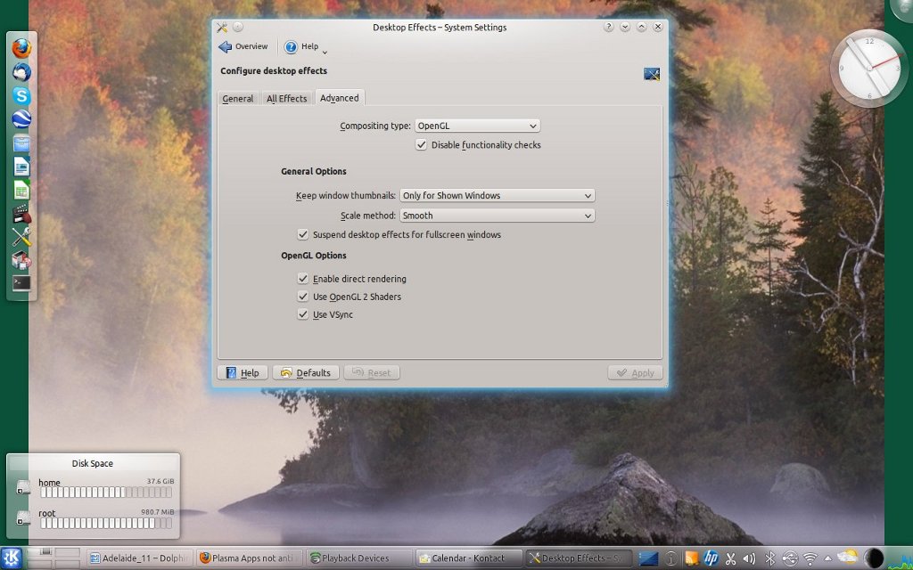

                      I have not have this sort of trouble, but the attached image shows my desktop with the Advanced Desktop Effects settings that I have. My video card is an ATI Radeon X2300.

                        Thanks for the info... My settings looks just like yours...
