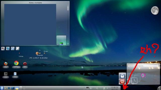

    After plugging and unplugging a projector, I now have this strange situation (see image) which I can not modify from settings panel. Any suggestions?

    1. Right click on desktop and click Unlock Widgets
    2. A cashew shaped button will pop up on one side of your panel. Click it.
    3. Some small arrows will show up on your panel. You can move these to adjust the length of your panel.
    4. Lock the widgets again when youre finished.
    This kind of things happens to me to when I run programs which change the screen resolution. My guess is that your projector did something similar?
      The cashew is already on screen in the far-right corner if you notice.
      The "problem" is that of screen resolution. The taskbar is set for a particular screen size but your actual screen size has been increased. If you right-click on taskbar select panel settings then select 100% it should fit the whole screen.
        That cashew isnt the panel cashew though. That would be the desktop/activity cashew that is always visible.
          Thank you very much, whatthefunk! You got it!
