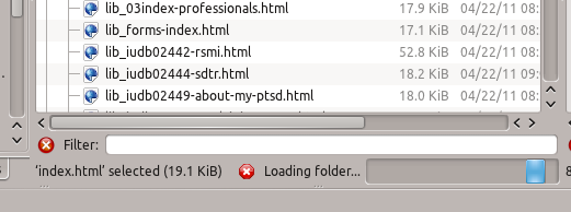

    Since the major upgrade to natty, I've had in most of my dolphin windows a "loading folder..." message, with a moving progress bar. It runs continuously. It can be made to go away, but clearly is not conveying anything meaningful (to me!), and is visually annoying. Look in the lower right corner of the attached image, to see it.
    Anyone else getting this strange thing?
