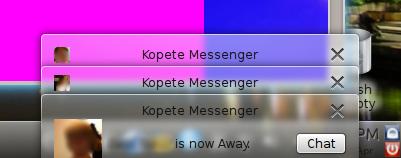

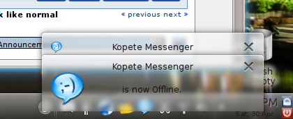

Okay so normally if you get more than one notification, they stack up. One after the other, they go higher up the screen and you can hover over the title of each one to see it. But, they aren't doing this, they're stacking down. Like, if I get more than one, they go down overlapping the panel and eventually go off the screen. The screenshot shows what I mean with two messages. I blurred out the names. And btw, if I had gotten more notifications they would've kept going down.
