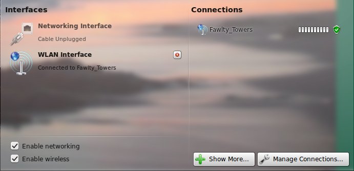

        I hope that I am not over simplifying your problem, but I connect using either wired or wireless depending on the situation. I did have a message regarding not being able to connect to the network which was solved by clicking the Network Manager check boxes shown in the attached graphic.

          @Noworries , everything is correct there , I did check and network was enabled there.
