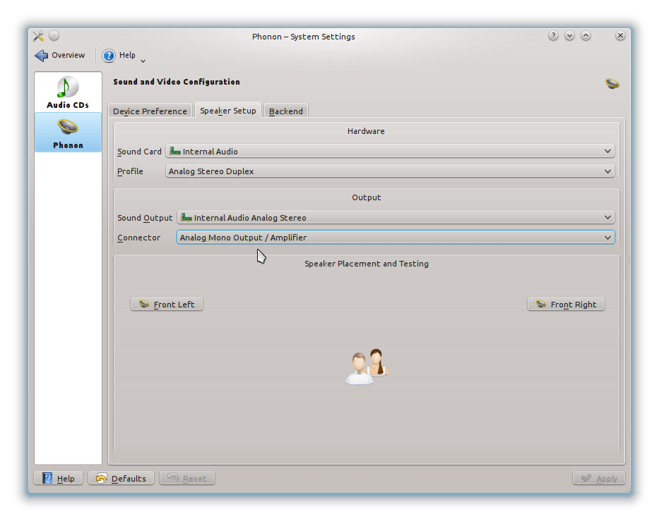

                      I know this thread is solved, but my solution was different yet relevant. I had the exact same problem and this was a top Google search for this issue.
                      My solution was also in "System Settings - Phonon - Speaker Setup" as a previous post listed. I only have 1 sound card (unlike the OP), but my fix was to change the "Connector" drop down list from the default of "Analog output / amplifier" to "Analog output mono/ amplifier", (see image below). I guess my internal speaker is Mono only so this fixed it for me.
                      Hope this helps someone else out there reading this thread like I was with the same issue.
